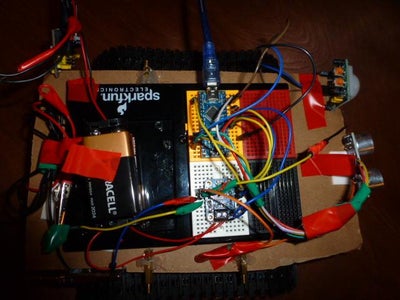

Step 2: Wiring
* Connect all three wires to one breadboard bus and link one other wire back to the respective Arduino pin.
This is the hardest part.
Because there are so many wires, I didn't make a circuit diagram, but the list below shows the pin numbers.
Pin Numbers:
  • "R" pin of your SMD RGB LED to pin 2 *
  • "B" pin of your SMD RGB LED to pin 3 *
  • Output of your PIR to pin 8
  • Trig of your HC-SR04 to pin 9
  • Echo of your HC-SR04 to pin 10
  • Switch of your relay to pin 11
DRV8833 Pins:
  • AIN1 to pin 4
  • AIN2 to pin 5
  • SLP to 3.3 V
  • BIN2 to pin 6
  • BIN1 to pin 7
  • AOUT 1 to Left Motor, Labeled Side
  • AOUT 2 to Left Motor, Unlabeled Side
  • BOUT 2 to Right Motor, Unlabeled Side
  • BOUT 1 to Right Motor, Labeled Side
  • Another thing about the motor wires - make up some alligator clip jumpers like I did here, put a breadboard jumper cable in one clip, and attach the other clip to the motor terminal. Do this for all four wires.
UV-C Light Wiring:
- Connect it to the relay like this(just don't do the ESP or circuit board).
Step 3: Assembly
Look at the pictures to see what I mean. A picture is worth a thousand words, right? :)
Follow the pictures of what it should look like.
Put standoffs in 4 holes on the chassis. Screw the nuts on the bottoms. Then make holes that align with the standoffs on a flat piece of cardboard that should be a little bigger than the chassis itself.
Screw the screws in the top of the cardboard holes and standoffs. There should be an aluminum foil baffle on the light's top.

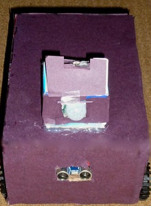

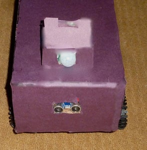

Step 4: Chassis Cover
Cut a hole in the front of the small box for the PIR.
Cover the cardboard box with black construction paper, like in the picture. Put the small cardboard box on the front of the top and glue it in.
Drill a hole in the bottom and top of the small cardboard box. Then drill a hole in the top of your large cardboard box that is in exactly the same spot as the hole in the bottom of the small cardboard box. This hole is for the wires of the PIR sensor and SMD RGB LEDs.
Refer to the pix for more.
Cut a rectangle in the front of the large box for the ultrasonic sensor.
