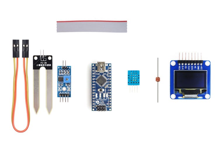

Required Materials

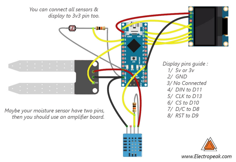

Circuit
Circuit
There are a few important points you should pay attention to. First, you need a power supply that can provide at least 5V and 20mA. If your power supply does not meet these conditions, you should connect modules to the 5V pin of Arduino (Don’t use 3v3). You should also note that an OLED display with SPI protocol is used. If your display is I2C, you must connect them to the A4 and A5 pins of Arduino. In addition, the moisture sensor used here has 2 pins and therefore an amplifier board with one analog output is necessary. The DHT11 sensor can measure both temperature and humidity, but we our code displays temperature only. You can add humidity by adding a few lines of code.

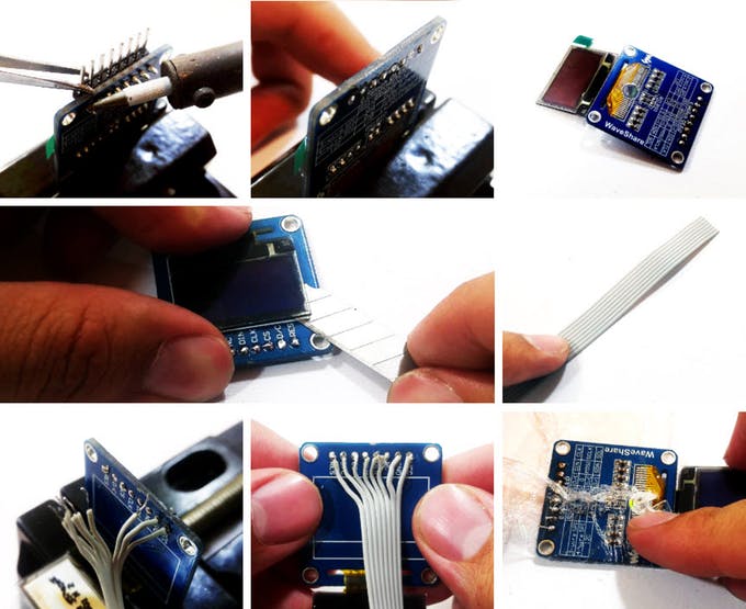

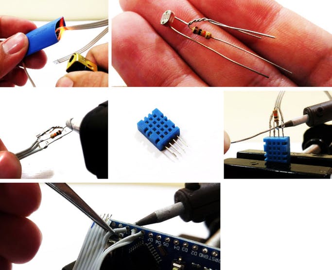

Since our flower pot is small and there is a space limit, we have used a thin ribbon wire which is suitable for our flower pot.

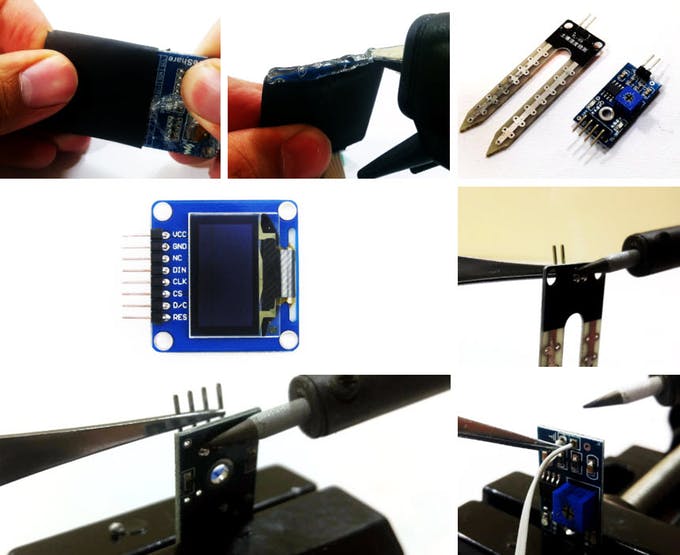

For connecting this wires, it’s better to separate the pin headers from the components. First, the OLED display pin header should be desoldered. To do this, you can use a soldering iron but heater soldering is preferable.
The OLED display is stuck to a board which provides the SPI communication. To have a better view of the display and hide wires, you can separate the display panel from the board. Use a sharp knife to do this.
Now its time to solder wires to the board. The board is going to be placed in a wet sand, so we must make all the connections and components waterproof. First, we cover it with a Plastic Wrap. Then we cover it by a shrink tube. You should heat it to stick to the board. Now fill the seams by hot glue.
The moisture sensor that we chose, needs to have a separate amplifier. First, separate the pin headers, then make them waterproof
For LDR sensor, You must connect a 10k ohm resistor between GND and sensor’s pin. This must also be made waterproof.
For Temperature sensor, You must connect a 10k ohm resistor between Vcc and Signal pin.

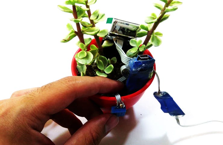

Now it is time to connect all sensors and display modules to Arduino Nano. After finishing the assembly, do not forget to also make Arduino waterproof.
Now empty some sand from the pot (not all of that, its harmful for the plant) and put the board and sensors (except temperature sensor) inside. The temperature sensor must be out of the pot. Now fill the pot with removed sand.
We are all done! Let’s upload the code.
