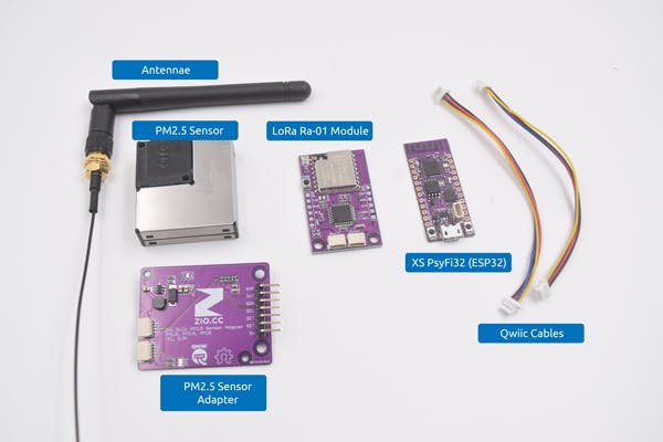

Setting Up LoRa Sender

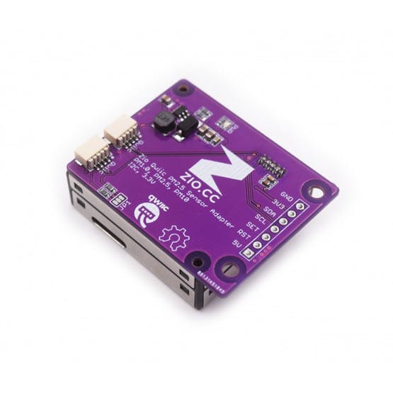

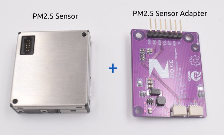

Below are the modules needed for the Lora sender. You need to attach the PM2.5 Sensor with adapter on the sender side inorder to detect Particle matter and measure the air quality.
Step 1: Attach the Pm2.5 Sensor and adapter together
Below is what it looks like after attaching the sensor and adapter together

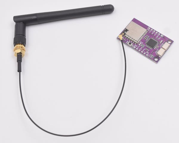

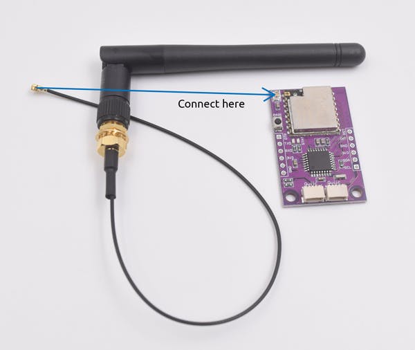

Step 2: Attach the Antennae to the LoRa module

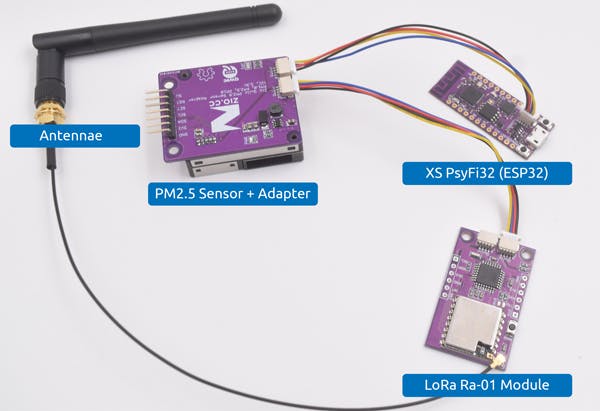

Step 3: Daisy chain all the components using Qwiic cables
Step 4: Download code and upload to PsyFi32
You can download the code from our GitHub page here.
Step 5 Connect to a power source

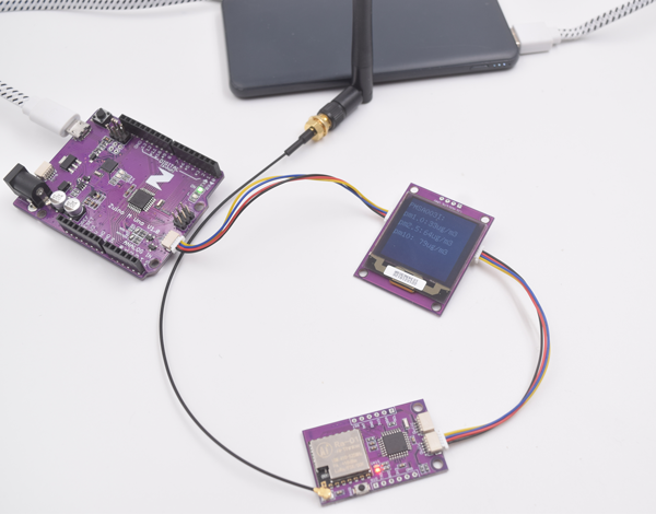

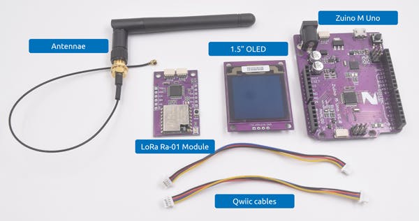

After setting up your Lora Sender, we need to set up the Lora Receiver. The data we have collected from the Lora Sender for the Particle Matter will be sent over to our receiver and displayed on the OLED.
Below are the modules needed for the Lora receiver.
Step 1: Attach Antennae to LoRa module

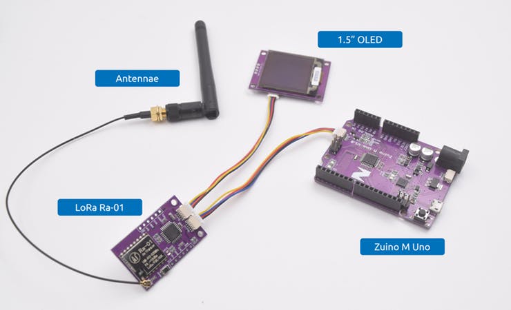

Step 2: Daisy chain all the components together using Qwiic cables
Step 3: Download the code below and upload to Uno
Step 4: Connect to a power source
After connecting to a power source (we use a powerbank for this example), your Lora Receiver will receive data sent from your Lora Sender.
There you have it! Your very own Particle Pollution detector all set up! You can record your data by connecting to an IOT platform dashboard and have it monitored in real time!
