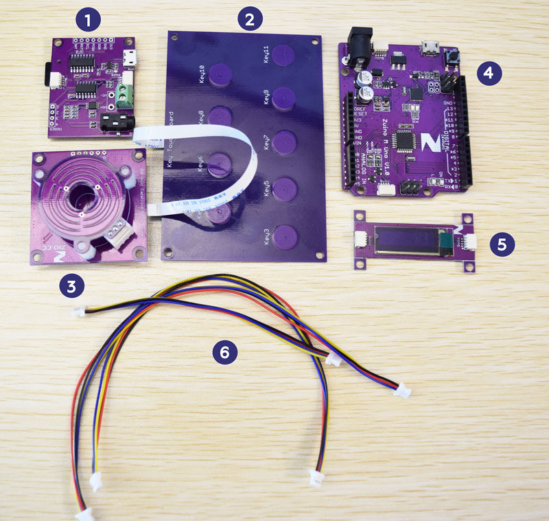

For this project we use the following components and modules:

Note: The Capacitive Touch Sensor should be set up with the Keyboard Touch and Wheel Touch module connected together with a ribbon cable.
We love using Qwiic modules for most of our project because it is pretty easy and simple to set up and assemble. You only need to daisy chain all the Qwiic modules together. There is no wiring complications nor the need to connect the modules in a particular order. All this can be done in less than 5 mins!
