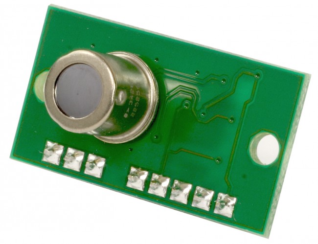

The TPA81 is a thermopile array detecting infra-red in the 2um-22um range. This is the wavelength of radiant heat. The Pyro-electric sensors that are used commonly in burglar alarms and to switch on outside lights, detect infra-red in the same waveband. These Pyro-electric sensors can only detect a change in heat levels though – hence they are movement detectors. Although useful in robotics, their applications are limited as they are unable to detect and measure the temperature of a static heat source. Another type of sensor is the thermopile array. These are used in non-contact infra-red thermometers. They have a very wide detection angle or field of view (FOV) of around 100° and need either shrouding or a lens or commonly both to get a more useful FOV of around 12°. Some have a built-in lens. More recently sensors with an array of thermopiles, built-in electronics and a silicon lens have become available. This is the type used in the TPA81. It has an array of eight thermopiles arranged in a row. The TPA81 can measure the temperature of 8 adjacent points simultaneously. The TPA81 can also control a servo to pan the module and build up a thermal image. The TPA81 can detect a candle flame at a range 2 metres (6ft) and is unaffected by ambient light!

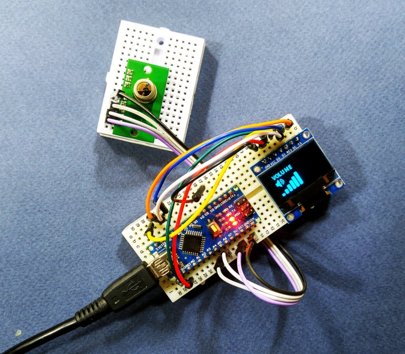

In this project, We decided to make a gesture detector system using PIR and Arduino. We have used TPA81 as PIR but it’s a little expensive, so if you want to save money, you can use 8 simple PIR sensors without the white head (The focus part). TPA81 support I2C protocol and it is compatible with Arduino Nano. This cool project helps you to find out the basics of image processing and gesture detection. Let’s do it!

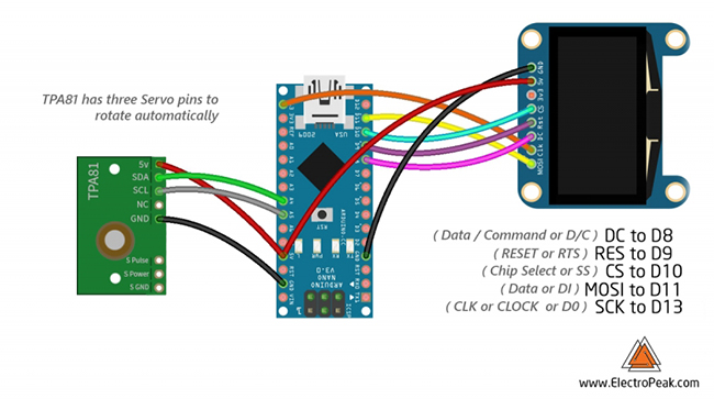

Circuit
If you want to use 8 PIR sensors instead of TPA81, You should connect 8 single PIR sensors to an Arduino board and read them one after each other. This way you can save some money!

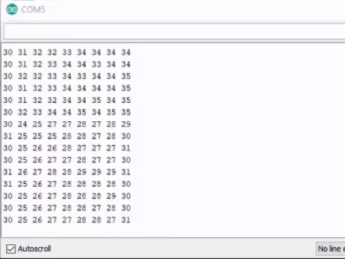

After running this code, Open the Serial Terminal in Arduino IDE and look at the 8 array temperature sensed by TPA81. the first number in each line belongs to the total temperature. Now put your hand in front of the sensor and see the temperature of your body. To define a gesture by hand, you should know your hand temperature and set it as an offset. We set it to 29 degrees. Upload the next code to see your hand movement in front of TPA81.

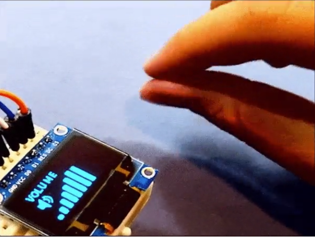

We wrote an algorithm to detect a simple gesture like increasing or decreasing the volume of a sound player. You can copy the following code and try it.
