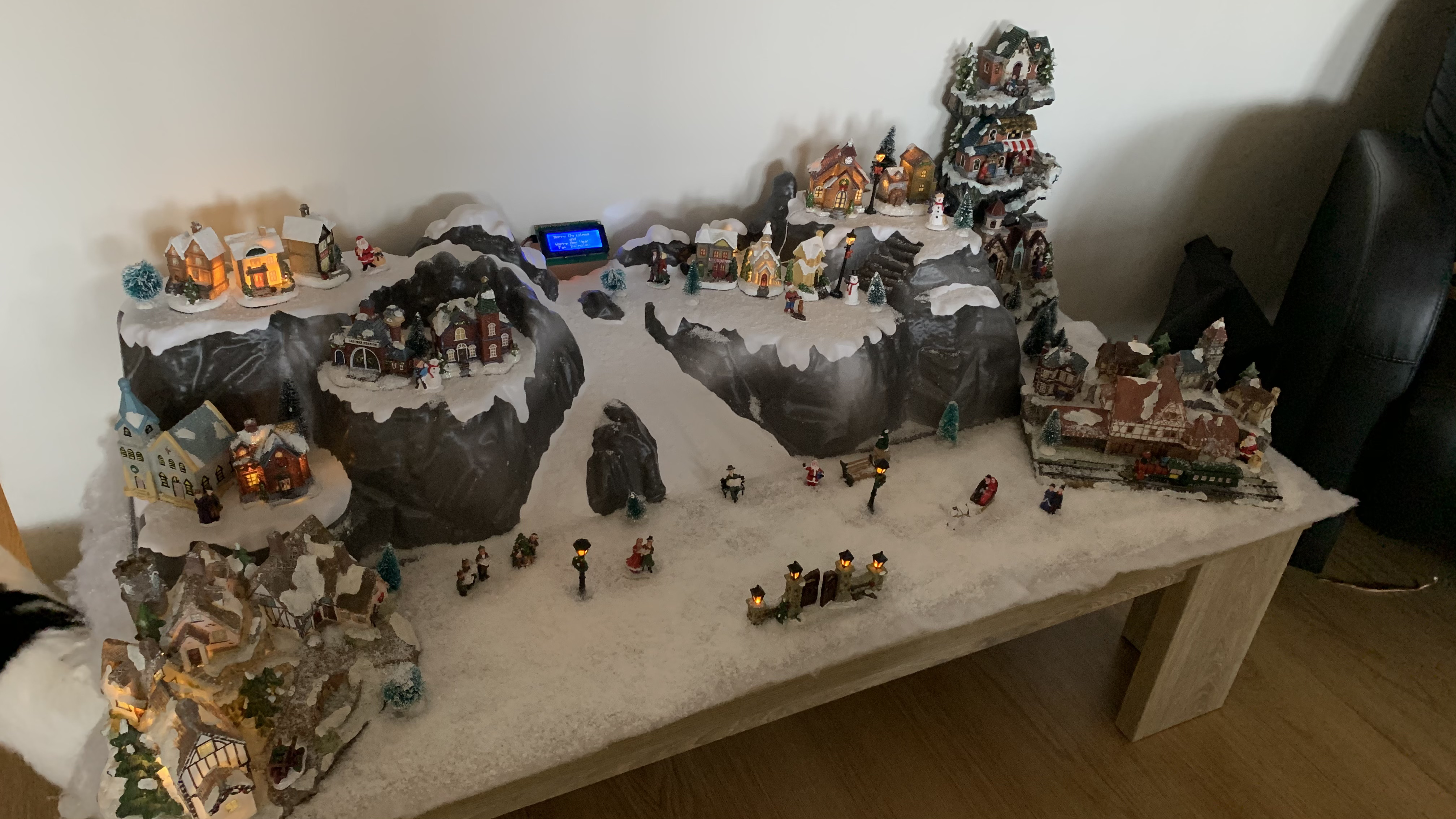

Project adjusted to be used in a Christmas Village with LED lights. No relay's needed. Small adjustment in code.
                                This project shows you how you can automate the lights of your Christmas Village. On the photo there is also an LCD 20x4 display, but is not going to be used in this project.
                                I saw the original project last year and always had in mind to build it myself. Since I live in an apartment in the Netherlands, it is not possible to use outside decoration. So what we do, is setup a Christmas village. But, like all other Christmas villages, the lights are all on or off.... It is not realistic.
My idea was to use the Arduino to control the lights in the village, but also Chrismas Lights flashing to the music. So I took the original idea and adjusted it, so I can use it in the village.
Without the music, I programmed it with a randomizer. To let it work with music, it uses MIDI.

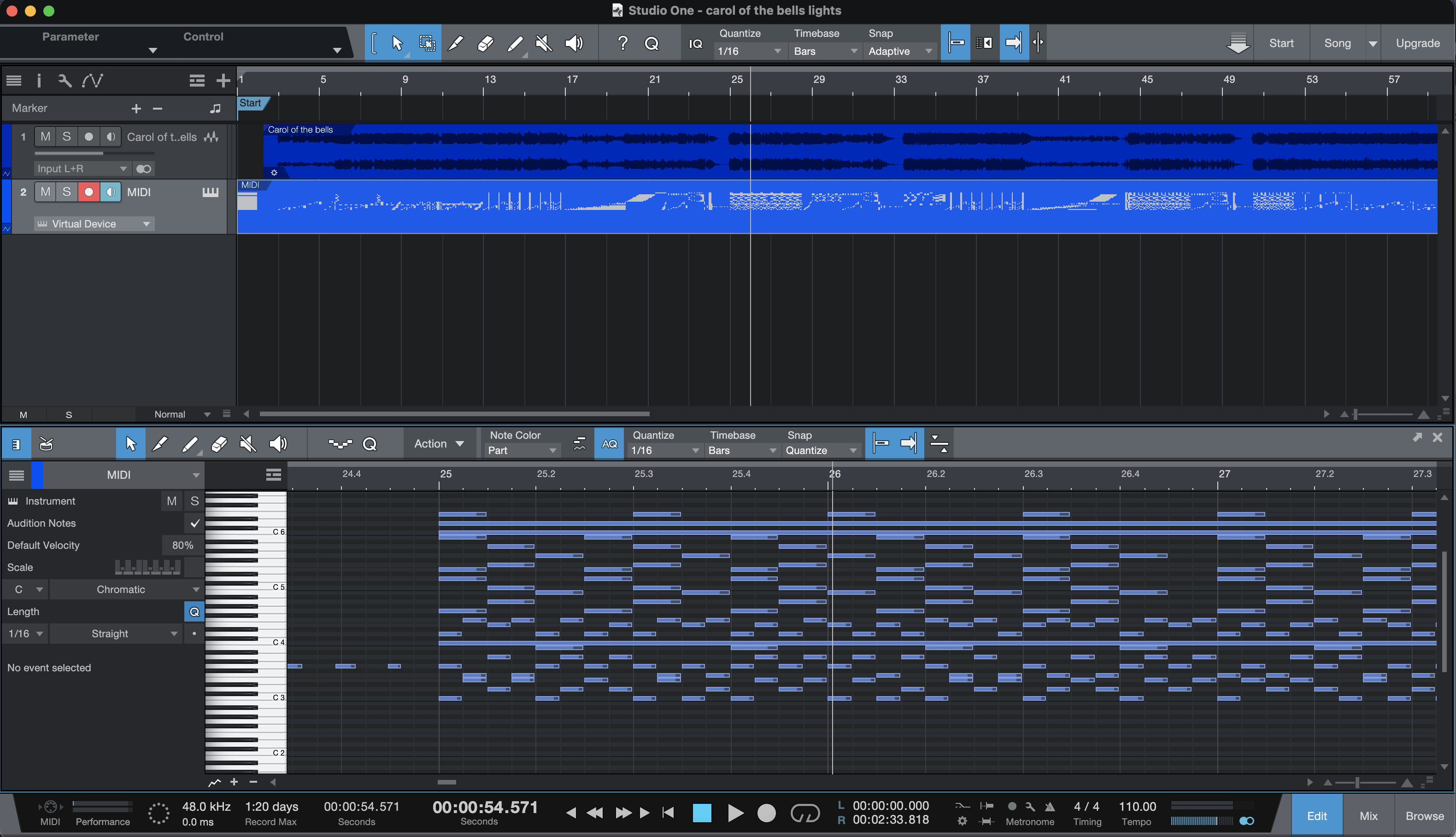

Controlling Lights in Sync With a Song
                                From the original project: Above is a screenshot of Studio One DAW software (digital audio workstation software) that I used for this project. The MIDI track in the DAW software is in sync with a song. I turned the notes from C3 to E6 (excluding sharp notes) on and off in the MIDI track to control the lights. I used Hairless MIDI to serial bridge (Mac users: there is a 64bit version, but not stable when using Big Sur) to send the MIDI signals to the Arduino and programmed it to turn specific relays on and off according to the notes received. Now the DAW software controls the lights according to the song’s rhythm.
I did not use sharp notes (the black keys) because, if you have a real MIDI keyboard, you can program the lights with it. You can play a Glissando and control all the lights!

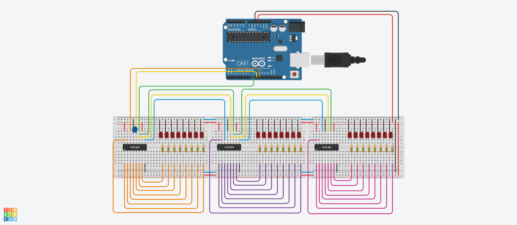

                                The leds are connected to the tree 74HC595 with a resistor of 150 ohm between the ic output and the leds. Three bytes are used to store the light states in the program (on/off). The music software sends out the MIDI data, which is received by the Arduino and sets the corresponding bit of one of the three bytes to 0 or 1. The three bytes are shifted out of the registers and then are latched on so the leds turn on/off. After all the bytes are sent and the process is finished, they are latched, which prevents the leds from turning on/off while shifting the data. Now get ready to build your own Christmas light show with Arduino!
Building the Circuit for Our Christmas Light Show With Arduino
Set up the circuit as shown in the diagram.

- Install Studio One (or any DAW software). I used Studio One 5 Free! Most of the features work in the free version.
 - Install loopMIDI for creating a virtual MIDI port (windows).
 - Create a virtual MIDI Port on Mac OS (using Audio/MIDI Configuration)
- Set up the loopMIDI/virtual MIDI port as a new instrument in the DAW software.
Windows Studio One 5:
-  Press Ctrl+,
 - Go to ‘External Devices’
 - Add
 - New Instrument
 - Give it a useful Device Name like "Virtual Instrument"
 - Send to: loopMIDI port
 - OK
 - OK
                                Mac OS Studio One 5:
- cmd+,
 - Add
 - New Instrument
 - Send to: IAC Virtual MIDI Cable
 - OK
 - OK
                                Open this file for the song "Carol of the Bells", click the area shown below and select Virtual Instrument
                                If you are not using Studio One, you can start a new song, create a MIDI track, and send its output to the newly created instrument.

Below is the village. Please ignore the lcd-display. It is not in this project, just something extra...
                                As said before, I also created a script to look like the village is alive, when I don't have the laptop connected to Arduino. So if you want to do that, please upload the following code to your Arduino
