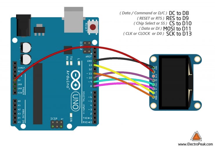

Circuit
There are different SPI OLED displays with different pin names. Use the circuit illustration above to find out the meaning of your module pin names. Most of the OLED modules work with 3.3 Volt power too. You can change the pin of Arduino but you must change it in code too.
