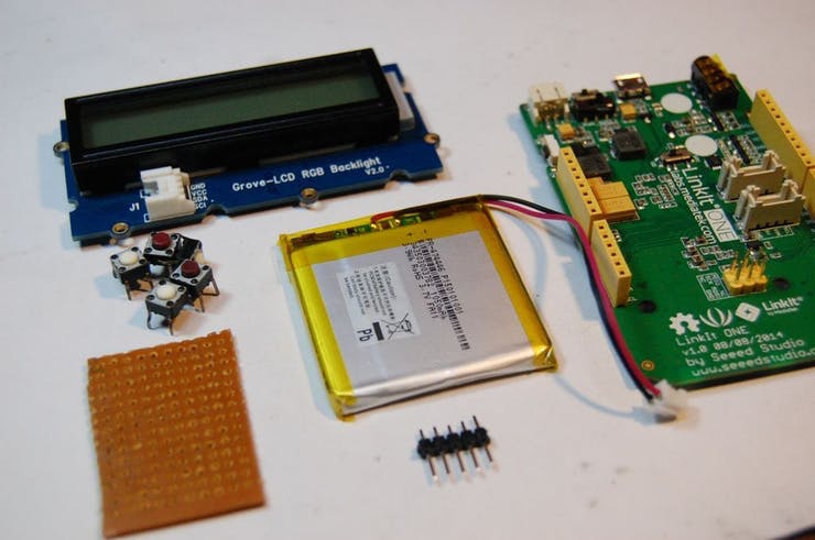

Bill Of Materials:
  • Seeed)
  • Li-ion battery (The linkit one box includes one)
  • General purpose PCB
  • Male headers
  • 5 push buttons
  • Seeed)
  • here)

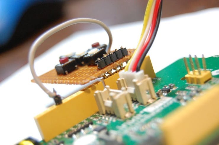

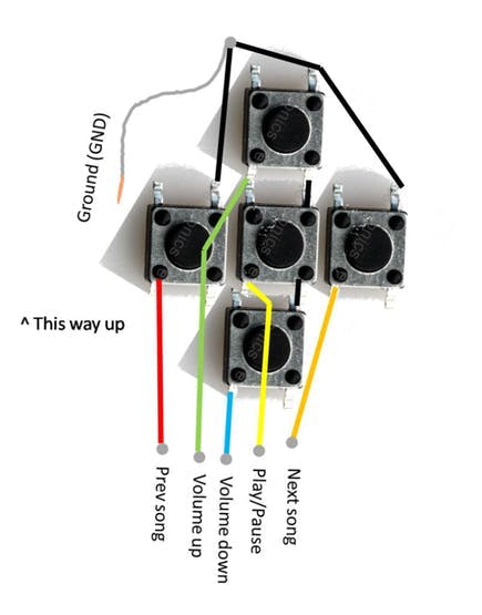

There are 5 buttons in all, each for Play/Pause, Next song, Previous song, Volume Up and Volume Down. The diagram above shows the arrangement of the buttons on the PCB along with the connections. Feel free to change the pin configurations (though remember to modify the code accordingly); here are my connections:

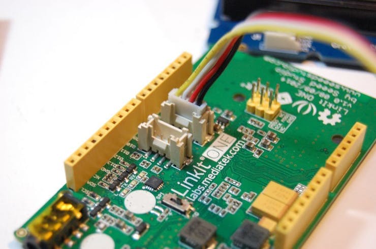

What's great about the Linkit board is that it already has a grove 4 pin connector built-in, to which we can directly connect the LCD. No shield required!
Step 4: Connect The Button PCB...
Here are the pin connections again:

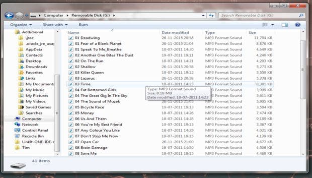

Convert The Songs to.mp3,.wav, or.aac (if it isn't already)
  • Media Human converter)
  • Select songs to convert
  • Convert songs to.mp3 (constant bitrate),.wav (though this creates HUGE files), or.aac (recommended, best sound quality)
Transfer songs to SD card:
Make sure all the songs aren't in a folder.

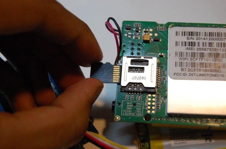

Step 6: Insert The SD card...
