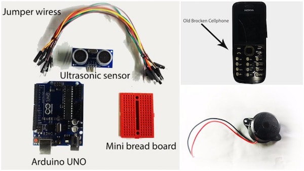

Other tools needed:
  1. 3/4-inch diameter PVC pipe (for the walking stick)
  2. 3/4-inch diameter PVC elbow
  3. Insulation tape
  4. Some small screws for mounting Arduino
  5. Screwdriver
  6. Utility knife
  7. Instant adhesive glue
  8. A box for your Arduino and other electronics

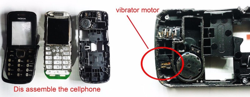

Salvaging the Vibration Motor from a Cellphone
You'll need to remove the vibration motor from a broken cell phone, which takes care and patience. I used a micro vibrator motor from an old broken cell phone I had lying around, because it's very small and works with low voltages.
Unscrew the cell phone and disassemble all the parts as shown in the above images. The vibrator motor is located at a side of the phone's case. Carefully remove the motor from the cell phone.

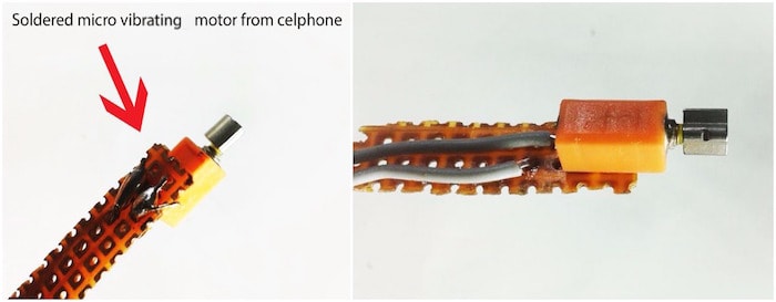

Now solder the motor on a small piece of general purpose PCB. Then solder two wires to the terminals of the motor as shown in the above images.

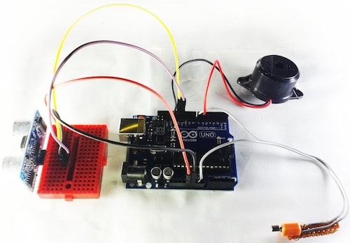

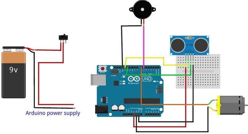

Interfacing the Arduino
Now it's time to wire the Arduino! This is pretty easy and doesn't have any complicated wiring. See the schematics below and carefully connect all parts to the Arduino. I used a mini breadboard to connect the ultrasonic sensor to the Arduino using jumper wires. Other parts, like the buzzer and motor, are directly connected to the Arduino. You can see the wiring diagram below.
Here are the connections for each part:
  • Ultrasonic VCC to Arduino 5V.
  • Ultrasonic GND to Arduino GND.
  • Ultrasonic TRIG to Arduino D12.
  • Ultrasonic ECHO to Arduino D11.
  • Buzzer RED to Arduino D8.
  • Buzzer BLACK to Arduino GND.
  • Vibrator motor pin 1 to Arduino D7.
  • Vibrator motor pin 2 to Arduino GND
  • 9 volt battery RED to Toggle switch pin 1.
  • 9 volt battery BLACK to DC male power jack(-).
  • Toggle switch pin 2 to DC male power jack (+).
Now we finished the wiring!

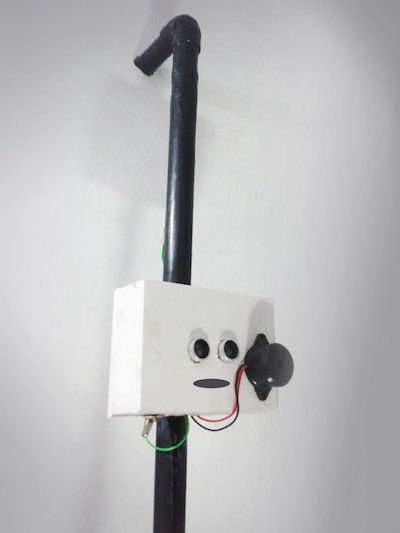

Assembling the Arduino Smart Cane

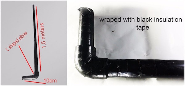

I used a PVC pipe to make the walking stick. If you have a walking stick lying around your home, you can use that, otherwise, you can follow this step. I used a 3/4-inch diameter PVC pipe and an 'L' shaped elbow to make the walking stick. Take a look at the above images to make the walking stick and follow these instructions:
  • First, take a PVC pipe (3/4-inch diameter) and cut a piece of it that is about 1 1/2 meters long.
  • Take an L-shaped elbow and attach it to one end of the pipe.
  • Take another small piece of PVC pipe (about 4 inches long), then attach it to the other end of the elbow and glue it.
I wrapped the walking stick with black insulation tape because I like how it looks. You could even paint it.
Attaching the Components to the Smart Cane

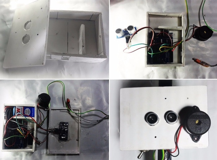

This is the hardest step in this project. It took me hours to design and fix the parts onto the walking stick. Find a box that you can use to put all your electronics together. I used foam board to make a box myself. You can do that easily.
Fix your Arduino in the box using screws. Now make two holes for fixing the ultrasonic sensor on the lid of the box as shown in the above image. I attached the buzzer outside of the box for better sound. Next, I attached the toggle switch at the side of the box and made a small hole for connecting the vibration motor to the Arduino. Fix the battery inside of the box and connect the power jack to the Arduino.
Now attach the box to the walking stick. You can either use screws or glue. I used an instant adhesive because it's quite strong. After attaching the box to the walking stick, take out the vibrator motor and fix it below the elbow. I used insulation tape for this.
That's it! We just made an Arduino smart cane for assisting blind individuals. Check out the demo video:
