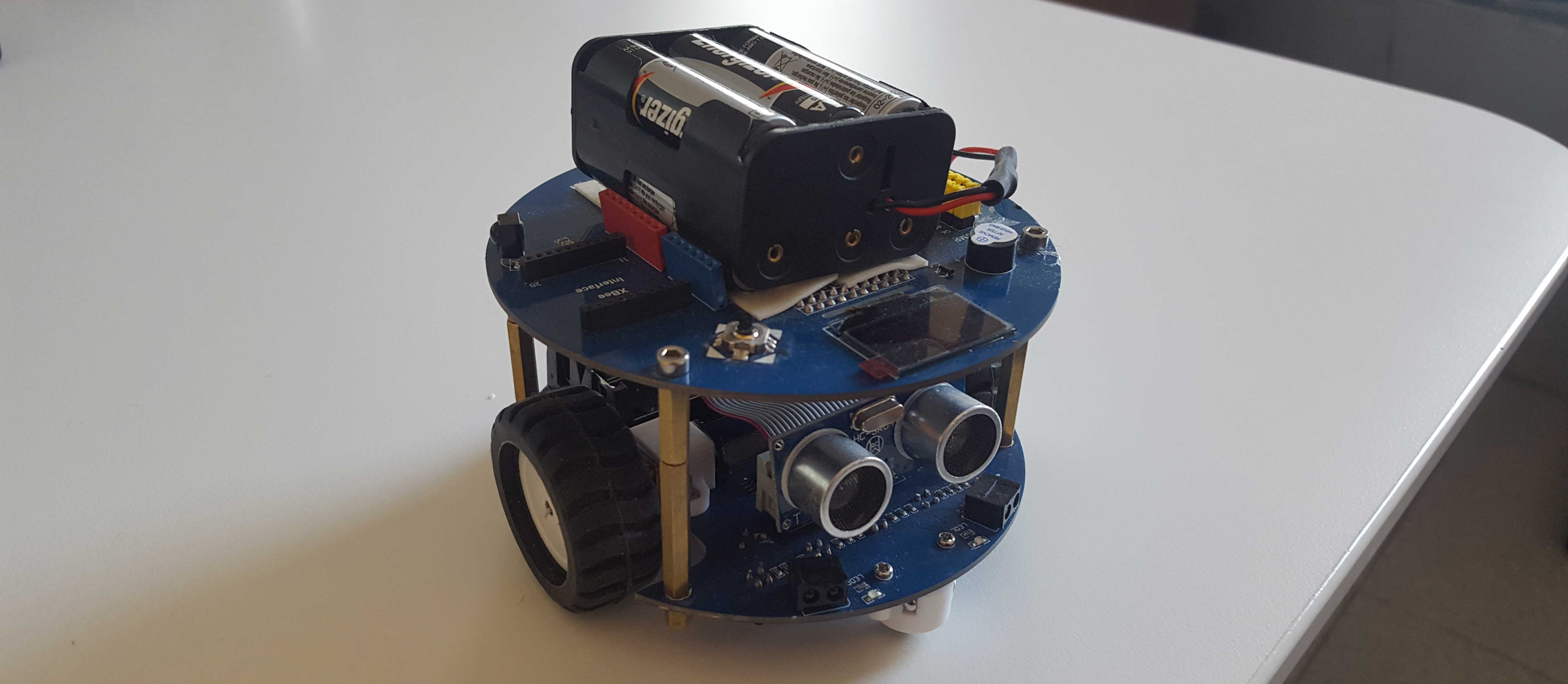

  • Robot. We used a 2 wheels robot with Arduino board and BLE radio interfaced with UART. Other kind of robots or custom ones can work as well.

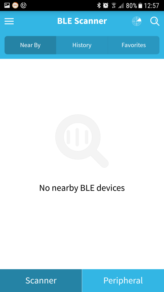

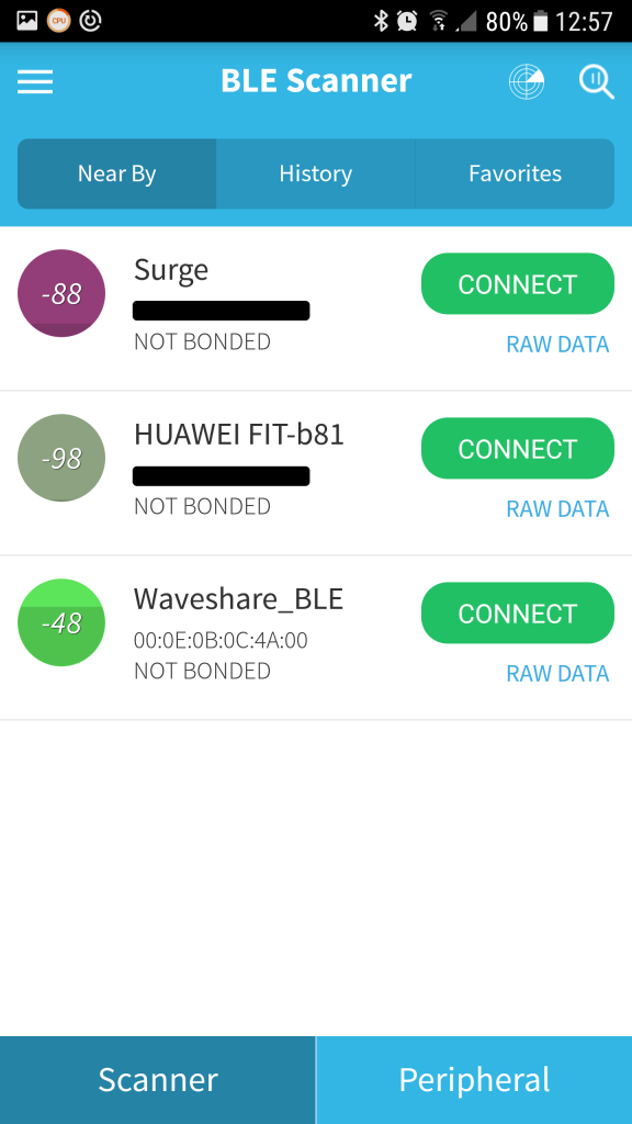

After our environment is configured and our boards are ON, we need to gather BLE MAC Address and Characteristic. To do so we used a free android application called BLE Scanner.
Few seconds after the application should show the robot’s BLE:
As we see, all BLE devices around us are showed in this section. We need to write down the Waveshare_BLE MAC address: in this instance it is: 00:0E:0B:0C:4A:00

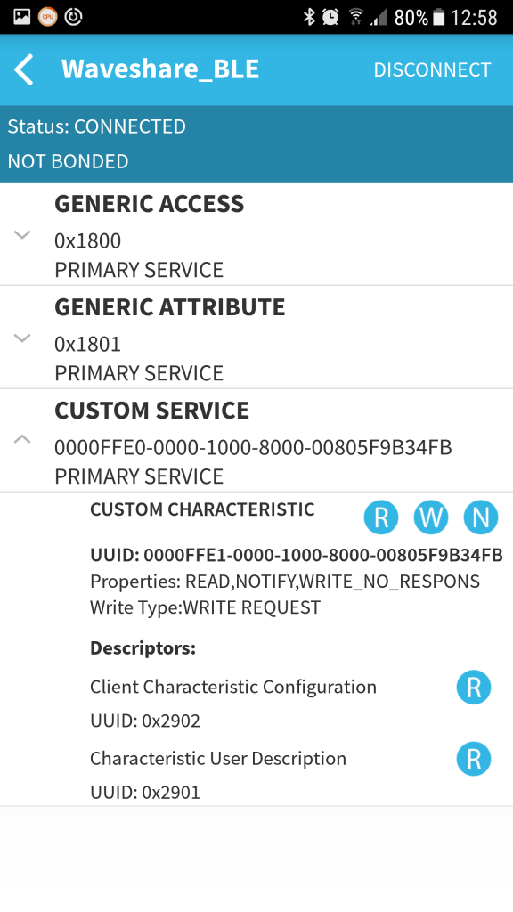

By clicking on the CONNECT button we access to device’s informations as attribute, service and custom characteristic.
Here we need to write down the CUSTOM CHARACTERISTIC UUID, in this case: 0000ffe1-0000-1000-8000-00805f9b34fb .

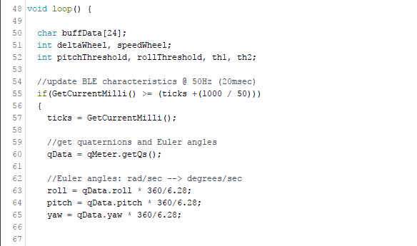

In this section we have the core of the sketch. At a frequency of 50Hz, we update quaternions and euler angles.

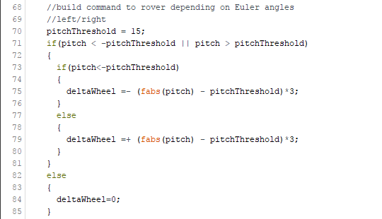

Analizyng pitch angle provided by Tactigon library, we can determine steering radius by slowing internal wheel and accelerating external wheel.

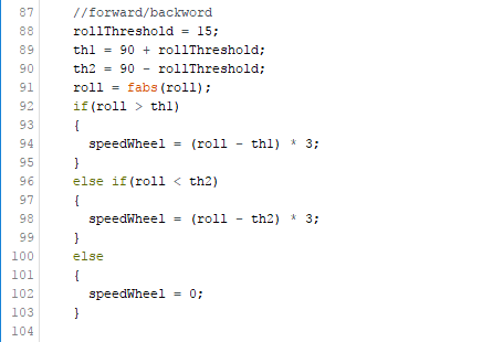

Analizying roll, instead, we can determine travel speed of the robot.

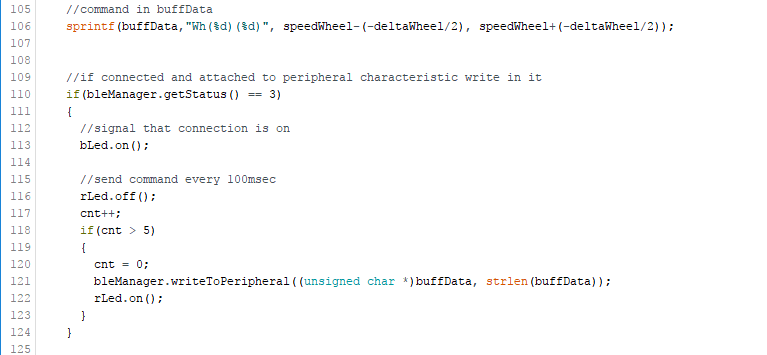

With a sprintf we prepare the buffer to write in the characteristic.

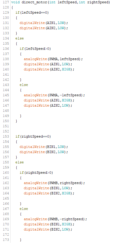

Robot Sketch

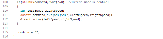

Since our Bluetooth sends received data over UART, we get wheels speed directly in the serial buffer.

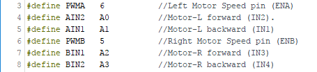

We have set robot pins as follows, all as output:
To parse the command we first read all the serial buffer and verify if it is longer than 0:
If the command contains “Wh” we can so parse the string and gather leftSpeed and rightSpeed.
The direct_motor function assign the speed transmitted by The Tactigon to each wheel of the robot. By doing so The Tactigon will act as a virtual-steering wheel!

    //command in buffData
    sprintf(buffData,"Wh(%d)(%d)", speedWheel-(-deltaWheel/2), speedWheel+(-deltaWheel/2));
    //if connected and attached to peripheral characteristic write in it
    if(bleManager.getStatus() == 3)
      //signal that connection is on
      bLed.on();
      //send command every 100msec
      rLed.off();
      cnt++;
      if(cnt > 5)
        cnt = 0;
        bleManager.writeToPeripheral((unsigned char *)buffData, strlen(buffData));
        rLed.on();
