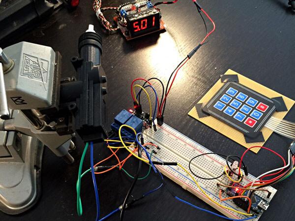

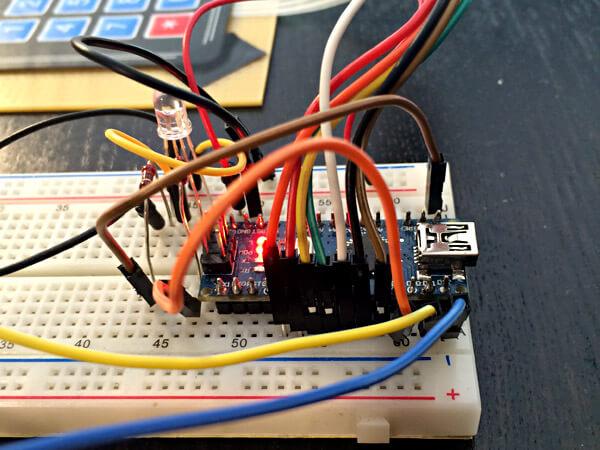

First insert the Arduino Nano into the breadboard, making sure that the two rows of pins are on either side of the furrow in the middle.
TIP: Position the USB mini port so that it faces outward from the breadboard. This way it will not clutter up your wiring with a USB cable running through it.

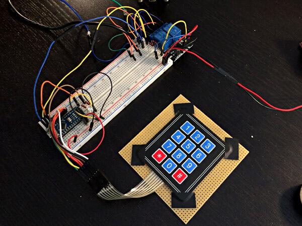

The 4x3 keypad used in this tutorial has 7 female pin sockets, all of which need to be wired to the Arduino.
The keypad module uses 1, 2, 3, 4, for ROW0, ROW1, ROW2, ROW3, and pins 5, 6, 7 for COL0, COL1, COL2.
Wire it up as follows
Keypad > Arduino
  1. > ROW0
  2. > ROW1
  3. > ROW2
  4. > ROW3
Pins:
  1. > COL0
  2. > COL1
  3. > COL2

Wiring the Arduino Nano to the Keypad
  • Arduino D5 -> keypad pin 1
  • Arduino D4 -> keypad pin 2
  • Arduino D3 -> keypad pin 3
  • Arduino D2 -> keypad pin 4
  • Arduino D8 -> keypad pin 5
  • Arduino D7 -> keypad pin 6
  • Arduino D6 -> keypad pin 7
Now it’s time to wire up the RGB LED. The only colors needed for display are: red and blue. From left to right (the LED has a flat side on its head) the pinout is RED, GND, GREEN and BLUE. Wire 5V to GND (Common anode) and set a 220 ohm resistor in series from pin 1 to D9 on your Arduino. Next, set a 220 ohm resistor in series from pin 4 to D8 on your Arduino.
