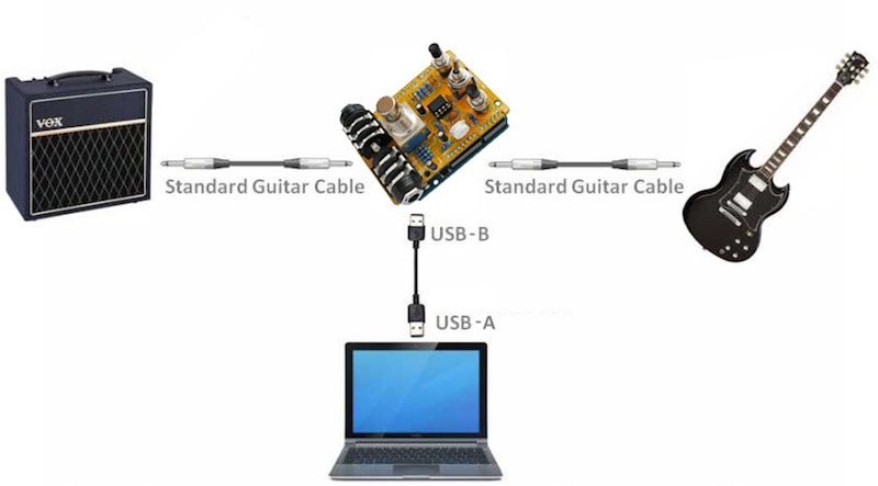

This is how you connect the system to your amp and guitar:

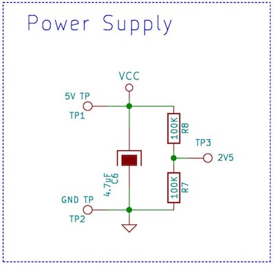

Power Supply: The pedal uses the +5V from Arduino Uno to feed the rail-to-rail operational amplifier and achieve design simplicity and maximum signal swing without clipping. A resistor divider R7&R8 generates 2.5V for virtual ground and the cap C6 remove ripple on the power line.
