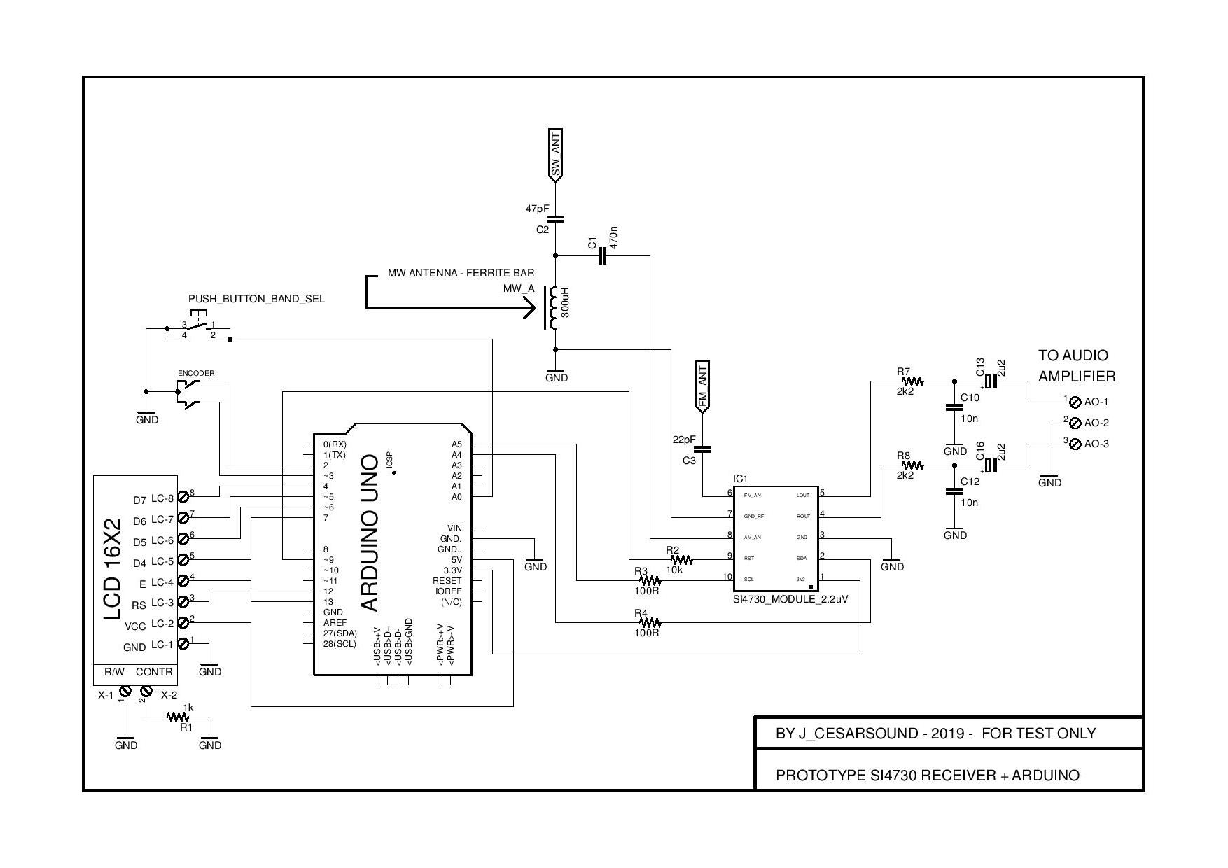

This is a small DIY Radio that covers all commercial Radio stations with Si4730 IC, plus All Amateur Radio bands when you use Si4732 or Si4735 IC.
The reason for the re-introduction of this radio is the new library created by Mr.Ricardo Lima Caratti for SI4735, which contains an updated sketch specifically created for this small receiver. If you are using a SI4735-D60 or SI4732-A10 based circuit, you can also use this sketch to add the SSB functionality to the original project. If you are using the original SI4730-D60 based circuit, the SSB will not work. However, the STEP, FM/RDS, MODE, AGC, Attenuation, bandwidth, Soft Mute, Audio Volume, and Shortwave will work fine. This sketch is very similar to the previous sketch (MIRKO_V1.ino). The new features of the MIRKO_V2.ino are shown below.
-New menu setup;
The receiver current status is stored into Arduino EEPROM;
FM RDS;
FM frequency step;
FM Bandwidth control.
